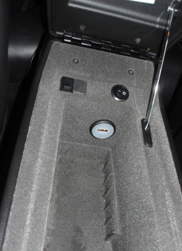

I forgot to share the semi-permanent setup I have at the moment. I’ve installed a random bluetooth receiver that my brother had bought for his BMW, but was taking too long to install So I got the two M-bus cables from the donor car, cut the bmw aux connector and added some molex connectors that I had laying around, to have a easy to use modular bluetooth setup Still the switch is in the boot. At the moment I am controlling the bluetooth and using the handsfree through my apple watch, until I find a complete solution through the OEM radio.
